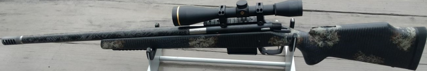

Here is an older picture of my 6BR hunting rifle with a Zermatt TL3 SA, it now has a McMillan Game Warden 2.0 stock with a Hawkins Hunter M5 3-Round DBM with their spacer kit. It cycles the 6BR cartridge with 70grn BT bullet (2.20" COAL) "Smooth as Butter". I can cycle the bolt slow or fast with ZERO issues.
I had a 6mm Dasher 700 Rem SA with a AICS M5 DBM with a Primal Rights 6BR magazine kit that cycled the 6mm Dasher with heaver bullets (longer COAL) 99% of the time with an aggressive bolt cycle and didn't cycle the 6 Dasher with 75grn or lighter bullets worth a darn.
