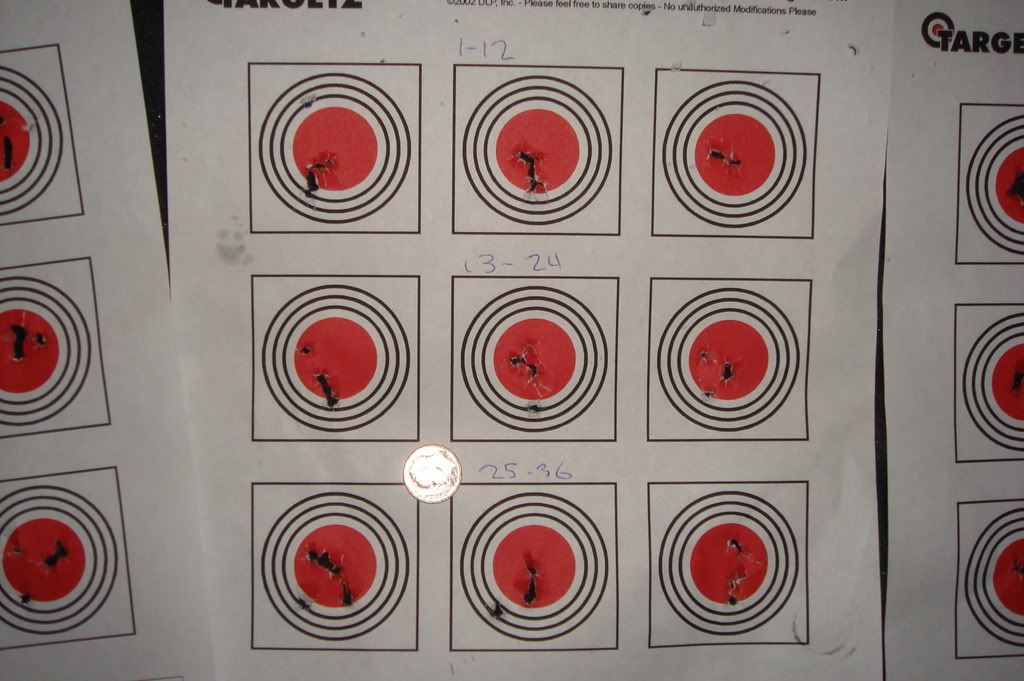

several years ago i was really into high end air rifles. i owned lots of guns over the years and out of all of them i ended up keeping a pair of customized Theoben Rapids that are very accurate, one in .22 and one in .25, and a Steyr LG 110 in .22. typically all of them will easily shoot dime sized groups out to 50 yards with very little effort. as far as filling with nitrogen...i don't know of any air rifles that are designed specifically for that. but if you want accuracy your going to want a pre-charged pneumatic type gun.

here is a picture of typical groups at 50 yards with a .22 rapid
