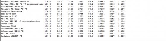

Have a jug full of 2200 and thought about using it to fireform / blow out some brass. Anyone used it in the 30BR successfully? Care to share data? Planned on using speer 125gr tnts for this process. Also have some old 130gr match bullets.
This would preserve my other more desired components for loading after formed when i should see it perform better.
I can't find any info on 2200 in 30BR other than this table I found on another thread, but given it's burn rate right it might be viable and wanted to see if anyone had experience.

With Lapua brass, 35.5gr of A2200 should put you in the neighborhood of 100% case fill, using a Speer 125gr TNT seated to an OAL of 2.3". Muzzle velocity would be around 2570 out of 23" barrel, and chamber pressure would peak around 41K psi.
Should work.
Alternatively, you could buy some LT-30 and Berger 115gr bullets, both of which are currently available, and use the barrel life you consume while fire forming to get in some bench practice.
I've never used the 2200 but given it's burn rate is right there with H4198, there's no reason it wouldn't work well for f-forming cases.
