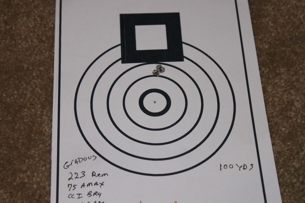

I just started shooting the 75 grain Amax from my .223. It has a 23" 8 twist Bartlein barrel. I have a .064" free bore and the COAL at jam is 2.495". My load is 24.5 grains of Varget .010" off jam. I only shot 50 rounds with this load, but it shot 5 shot groups at 100 yards in the 2's. I'm gonna try it out at 500 yards this weekend.
