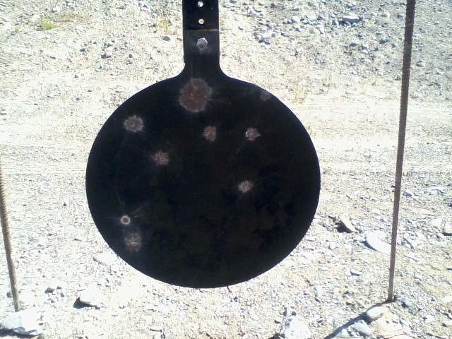

And, yeah, I only shoot 3 or 4 days a week. This was the steel I shot at 1,000 yards today, no cross-breeze at all. Come up from my 100-yd zero was 29.0 moa, adjustment to windage was ZERO.
WHERE IS THE "SPIN DRIFT?"
Oh wait, I know, I have to get out to 2,000 yards to see it, right?
