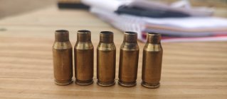

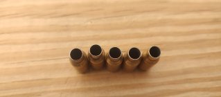

So long story Short ( and feel free to make fun of me and my ignorance if that what gets your jollies ) Im back playing with .22tcm and the main issue I'm having is my home made brass. Necks are too thick to chamber so had to neck turn right ? So did some reading watched some videos and got a lil K&M deal, .22 cal got a 23° cutter to match my .22 TCM sammi drawing for the should angle and all. So here the deal I guess I skipped over the Mandrel part because I was beyond confused why after I formed my brass I couldn't get it to go on my pilot..IMG_20250127_142340668.jpg
Noticed right about here , a bit below the case mouth there was always kinda a lil slight indent like a crimp. No maker how short I made my brass it was there
So after a lot of tinkering just decided I could make my necks longer and just trim that off ....which worked actually . Now got em to when I get stuff trimmed to spec that crimp or whatever it is is cut off and it slide on the pilot nice and easy
....well got to talking on discord and someone asked how I exposed the cases...and then talk of mandrel cam about ...and yeah .... Again guess I missed or skipped the part about mandrel but yeah ... So I got 25 piece made up like this ...so the question is how bad did I mess up ? Their goin in a lil 12" AR-15 so I don't need the upmost precision. Also how tight does it have to be for an expanded mandrel? At least for initial turning ? Again I'm JUST doing this to get my brass to chamber. I have a lil deal for I use for my case bulles that's basically an expander Mandrel ( more of an up dated M-die type deal ) and it's a
230 x .226 would .226 be too much for neck turning or ? Because I was worried about wobbling or something possibly. I mean I played with some and it seemed to work good but idk
( Messed this one up a bit jus playing around but all the others are in the dryer )
So...about how dumb was I ? Will these work half decent? Will I blow face off if I try them ? Or should they be fine for shooting varmints out of a 12" barrel AR pistol?I've only made 25 total I was planning on using so no biggie if I HAVE TO Scrap them
Thanks

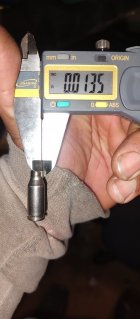

As far as measuring well it's less then ideal but it's been getting me brass that works so.. honestly I just keep forgetting to order a ball mic.. especially when I'm not sure what else I'd use one for past this

Good info above. Judging by your pictures above it appears you've turned 80% - 90% of the shoulder, that's too much. You only want to "kiss" the shoulder below the neck/shoulder junction to ensure removal of donut material that moved to exterior of your case during expanding.
I recommend a decent inexpensive ball mic to measure neck diameter, exacting precision for your stated use is not necessary. I bought this one, checked against feeler gauges it is spot on and works well for my needs.
Assume you're using NOE's expander plugs, they can work so long as you adjust your die to only expand the neck the first diameter. Personally, I'd get the correct expander and turning mandrels, polished SS will work fine for what you're doing, just be sure to use some lube (Imperial sizing die wax works well). A pair of SS mandrels from 21st Century are ~$30 less shipping.

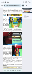

.....y'all do know that .22 TCM isn't a wild cat right ? I can buy factory ammo fairly cheap actually... And still have some of the brass from the last few boxes.... can't find brass for sale anywhere that's not a scam site though...which is weird... Anyhow I'm legit just messing with this stuff because it's neat .... Plus it's getting shot in a 12" AR pistol Soo....not really a precision deal
And nd on the should deal....though you supposed to mate the cutting edge with shr should neck junction and run it like that...which I did... I mean I guess I did go a lil over board but most of the stuff I read showed the should getting cut as well so...

Ouch on the turning here. Not trying to be too critical but I’d throw out the pieces you did and properly expand the necks to the proper size to just barely slip on to the turning mandrel. Clearly, your brass was wobbling all over the place when you turned these. Also, why are you cutting so much of the shoulder?

Well as far as I’m concerned when you make a case outta something else it’s a form of wildcatting and if you think turning that much in on the shoulder after you came on here and asked?…. Then I guess you got this. Good luck with your endeavors
Well like I said I was just trying to do what I read which was to set the cutter where it finished at the shoulder angle. And that's what I got. And actually a lot of the pictures I see are pretty similar including ones from this site so , honestly was just following the instructions.Screenshot_20250128-180755.png
