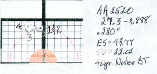

Nope, no experience with AA2520 in either of those calibers. However, I do use AA2520 with the 40 gr. Nosler BT bullet in my Savage 12VLP in .204 Ruger caliber. It shoots pretty good in my rifle.
