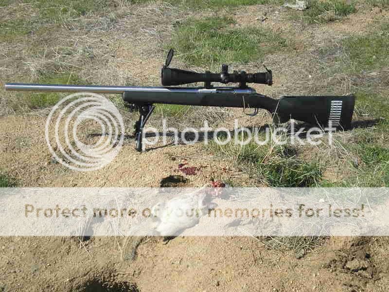

here is an upper chest shot on a G squirrel at about 300 yards. .223 with the 75gr Amax
