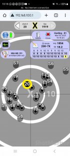

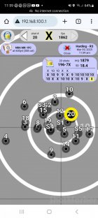

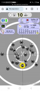

She does pretty good - Now I just have to learn how to read wind. During one of the relays, the flags at 300 were pointing to each other - how do you deal with that?
That aside, this is a personal best for me with my first clean. This is with a fireforming load going pretty slow, 2760. Can't wait to turn it up.
Scott

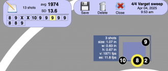

Today was one of those no temp change (+/- 5F), no wind days, so perfect to check existing nodes, and explore new powders on a limited basis, at 600 yds. The N540 Low Node was pretty stable, group wise, and the 1" group of the High Node is tempting to chase. Also, the impressive reality between the real target and ShotMarker - and I haven't calibrated this thing yet. But, there's also a tempting Varget load to look at.
Decisions, decisions...
