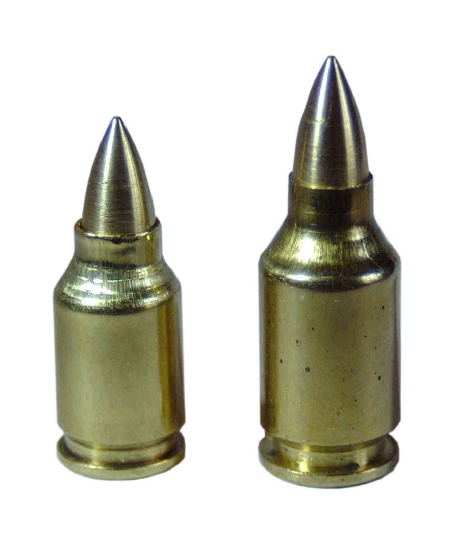

9mm necked down to .224 for auto loaders, 55gr fmj for range ammo, vmax or gamekings for self defense. Call it the 224 liberty
The .224 BOZ cartridge was developed in the late 1990s with the purpose of defeating body armour.[1] The .224 BOZ began as a 10mm Auto case necked down to .223. Original trials were successful, with this round firing a 50 gr projectile chronographed at over 2,500 ft/s (760 m/s).[2] Worldwide patents were applied for and granted.
In early 1999 .224 BOZ was fired in modified 10mm MP5 and 10mm Glock taking part in a head to head trial at DERA Fort Halstead (UK Defence Testing Establishment) against the NATO CRISAT specification target of layered titanium and Kevlar armour. These trials favourably compared the .224 BOZ against the 5.7 FN P90 and the HK MP7. The .224 BOZ was also shown at the Shot Shows 1999 and 2000, but the concept was solely to be made available for anti-terrorist and special forces use, not civilian use.
In 2010 work restarted on re-working .224 BOZ into a 9x19mm necked case to .223 and with a partnership with a leading ballistics engineer a new range of projectiles have been created. Despite decreasing the cartridge case volume velocities in excess of 2,200 ft/s (670 m/s) have been achieved.

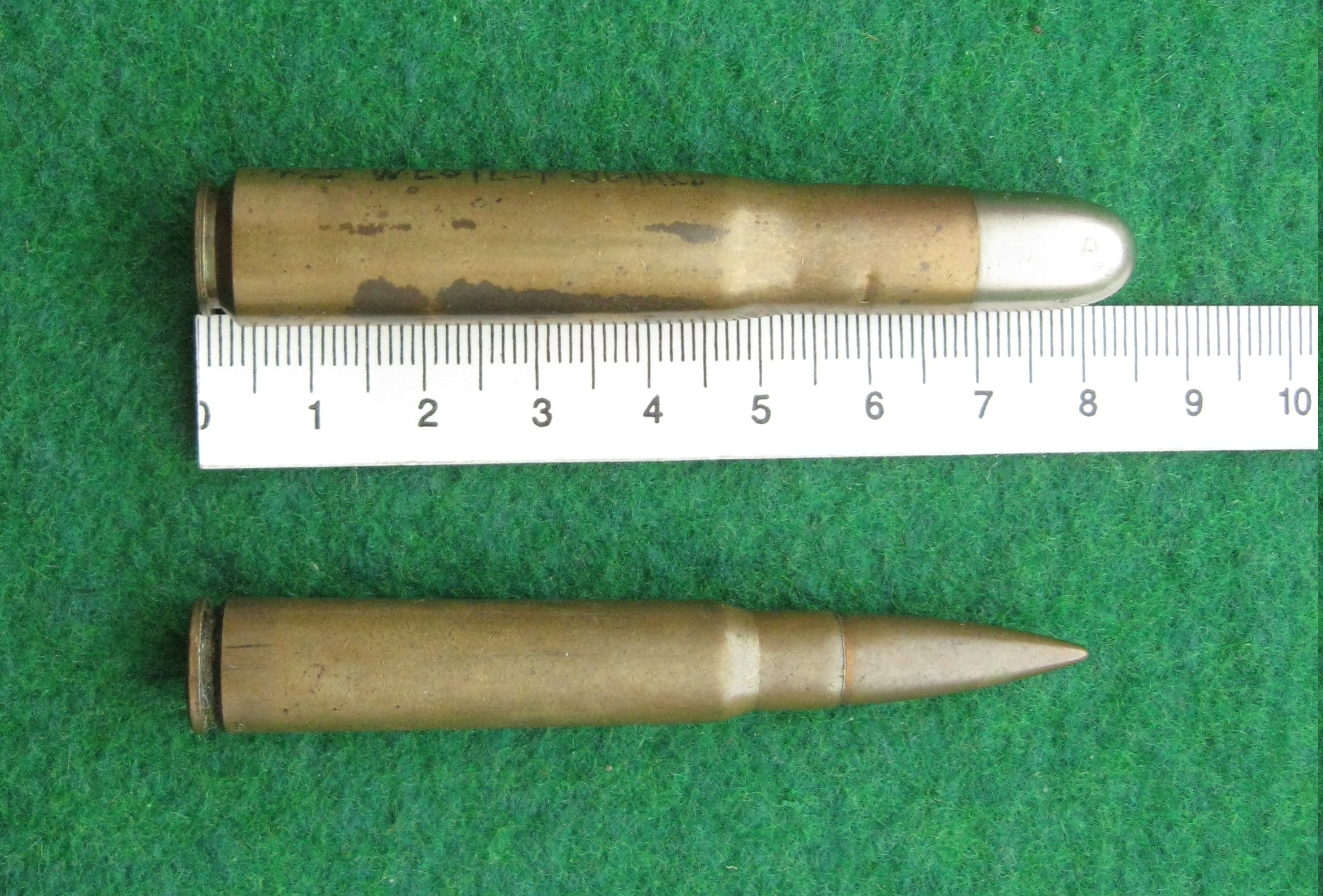

My designs revolve around the 426 Westley Richards casing.
Shortening to 2.50", 2.44", 2.00", 1.5" and necking to all popular calibers.
https://revivaler.com/the-425-westley-richards/
It's actually the Westley Richards .425 Magnum Express which was manufactured for use in the thousands of Mauser M98 rifles found in Africa. The rim was reduced to 0.473 to minimize the changes required to run in the Mauser rifles.
.425 Westley Richards at top and an 8x57mm Mauser below. Note the rim sizes are the same but the .425 Westley Richards case is of much larger diameter. (Picture courtesy valka.cz).
Yes, excuse me. 425 WR.
And the 0.473" rebated rim size to the 0.544" base size would allow use of standard bolt head diameter.
Ugh yes. Too bad its more intended for maximum speed, and armor piercing aspects. That is pretty neat, Though. I really would be crazy for a heavy .224 out of a 10mil, built for accuracy out of a semi auto handgun.

I saw a picture of .22 pokey (25acp necked down to 22) and it got me thinking about neat wildcats I wish existed. Lets hear your ideas.
I wish .22 pokey was a thing for magazine forward Olympic styled target pistols.
10mm necked down to .224 but using 80-90 gr bullets. Yes it would be quite long for the grip, but probably do able. I would like it for long distance handgun target shooting, in custom 1911s or maybe mag forward target pistols. Not sure about a name, but 22 autoturbo sounds pretty 80s cheesy. (I like 80s cheese)
And finally for my contender pistol, a centerfire 224 caliber that is subsonic. 1050 fps with those 90gr 224 bullets would make a sweet windbucking 200 yard paper puncher.

I have a 10mm/22 complete setup- both reamers, dies, case forming dies, etc. its a very wicked round
