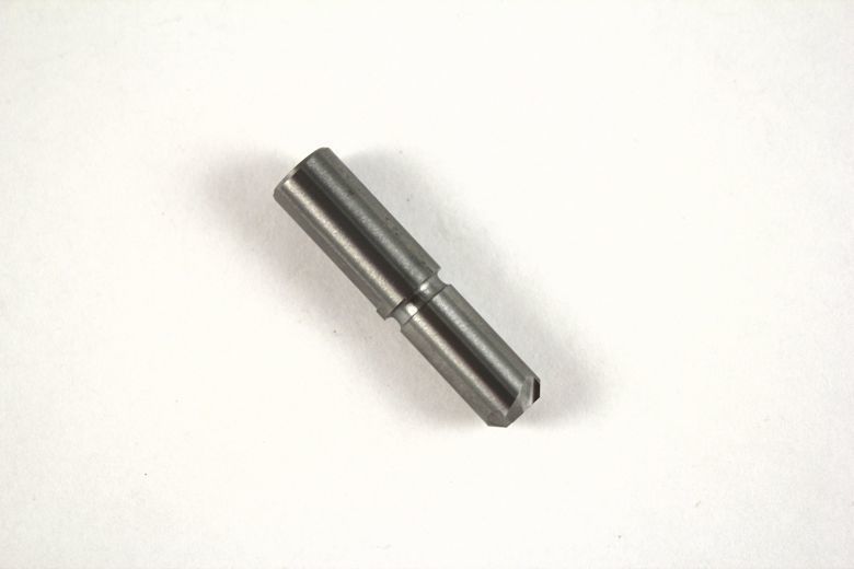

Great writeup Al, I was wondering what the difference in the end result would be if you used this carbide cutter/turning pilot made by K&M? Is there an advantage to the way you did it, not trying to argue or anything I am just getting ready to make some 30BR brass and trying to learn any ins and outs already figured out by others who have been there already. The 30Br is a new cartridge for me. I know 21st Century makes an adapter for their turner to fit this pilot, not sure about PMA. Thanks for all the great info you post.
Dave
The K&M pilot is used by quite a few people I know as a combination mandrel and donut remover.
This die is more for dealing with the external 'lump' at the bottom of the case neck after it's mechanically expanded and straightening the neck. The necks can be turned in one pass rather than removing the 'lump' and then final turning the necks.
For reasons I don't fully understand, this method also minimizes the internal donut. By pin gage, there's right at .0005 (half a thou.) internal donut...and some show less than that. It's small enough that you can push the case on the .3060 carbide turning mandrel and not have it hang up at the bottom of the neck.
My good pal Randy Robinett has been making his 30BR cases using custom ($$$) fixed neck dimension full length sizing dies for years....hard to image how many cases he's made that way. This is just my dirt-clod way of duplicating that process using commonly available, inexpensive die options as a starting point.
Just my 2 cents worth over my first cup of Sulawesi.....;) -Al
That is what I was looking for, makes a lot of sense. Thanks for the detailed explanation, very clear and concise as always, I appreciate it.
