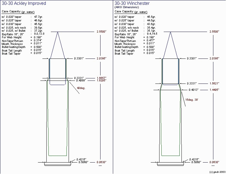

Here is a quick drawing of the dimensions for the .30-30 Win. Ignore the 'Improved" on the left, go with the one on the right.
