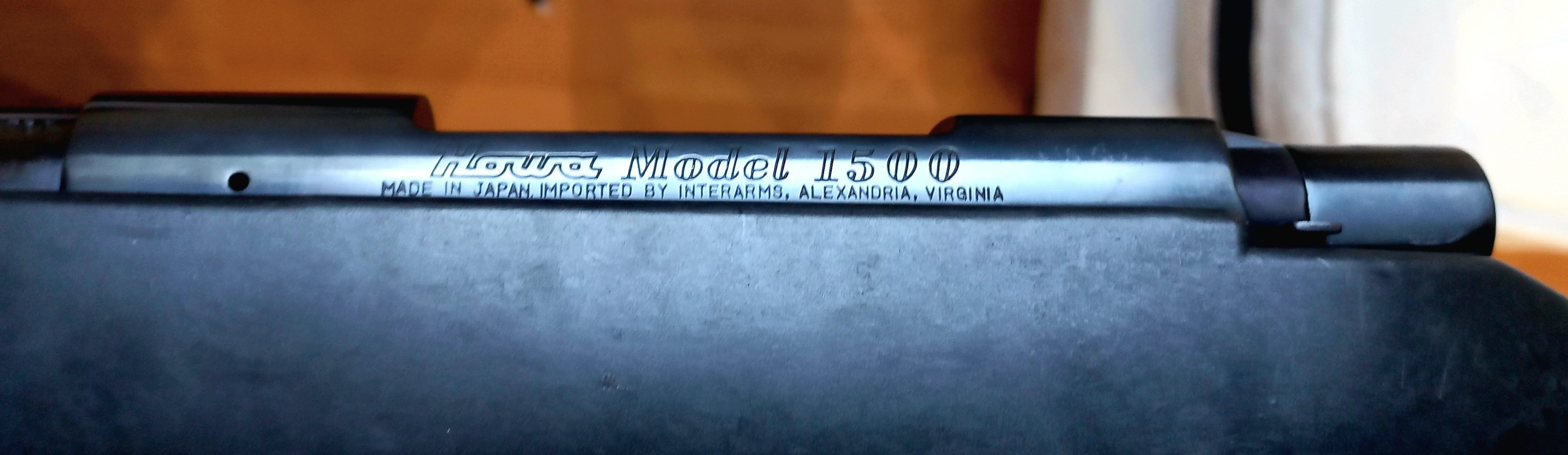

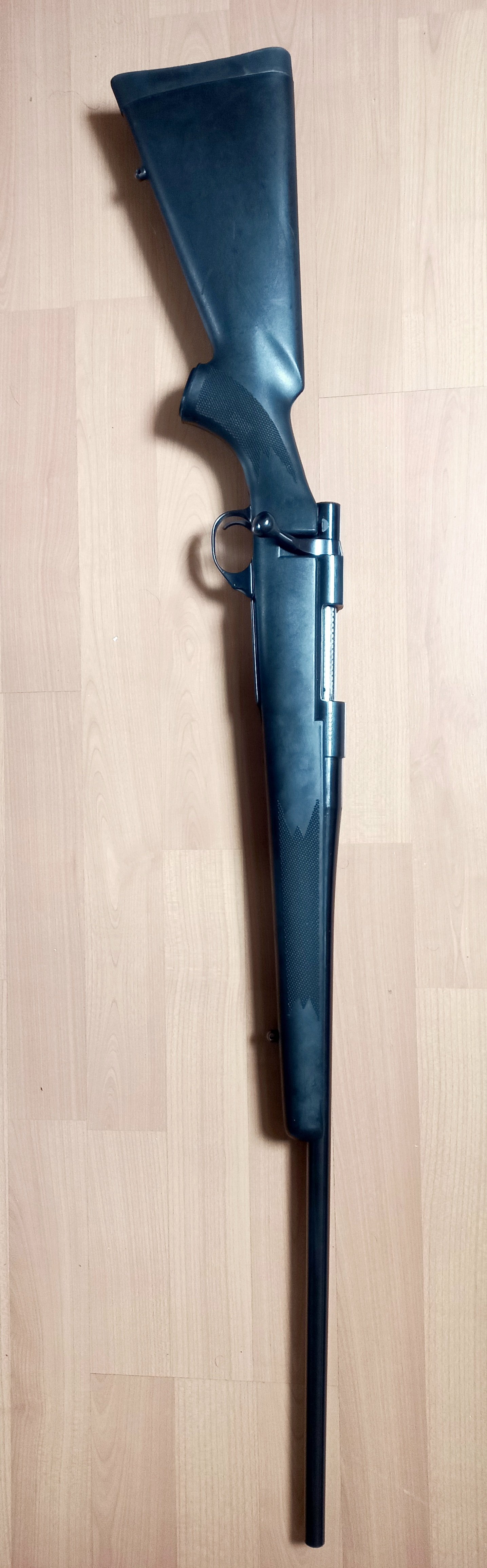

Hi there. I just purchased a Howa 1500 chambered in .250 Savage.
The 22" barrel is medium heavy and is original.
Have you ever heard of such an unusual chambering? When were those rifles manufactured?

Never seen or heard of the 1500 Howa in 250 Savage. Call Legacy Sports, Reno/Sparks, NV and ask them.
Nothing like getting the proper information from the horse. Google them up.
You may find that someone had that barrel/cartridge put on that action.
250 Savage is gone but not forgotten, it’s a great chambering. You can still find the brass and dies, just have to look a little harder. I didn’t know Howa ever offered it but I don’t doubt it, it’s been offered in other brands here and there. Ruger and a Remington come to mind.
Bill gave you some good advice, I’d check and see if it’s a custom barrel or factory offering. Either way it sounds like a neat little rifle.

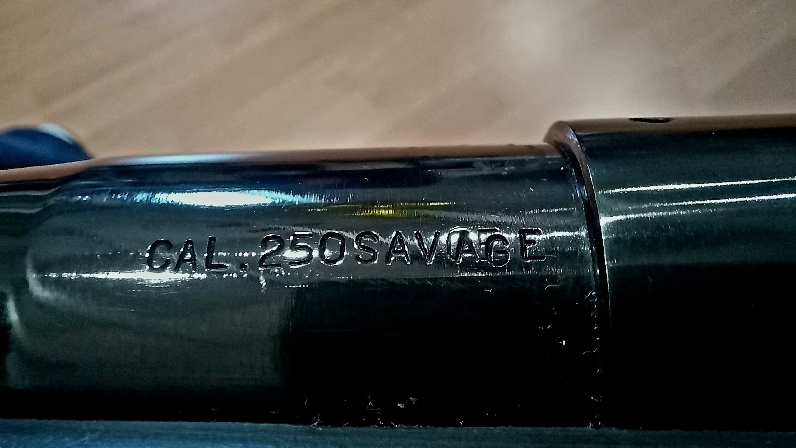

Just received the rifle this morning and Bill was right: it appears to be a rebarrel job, not only because there are no company markings on the barrel and no proof marks, but also because the gunsmith made an obvious mistake when he stamped the caliber, forgetting an "A" and correcting it afterwards.

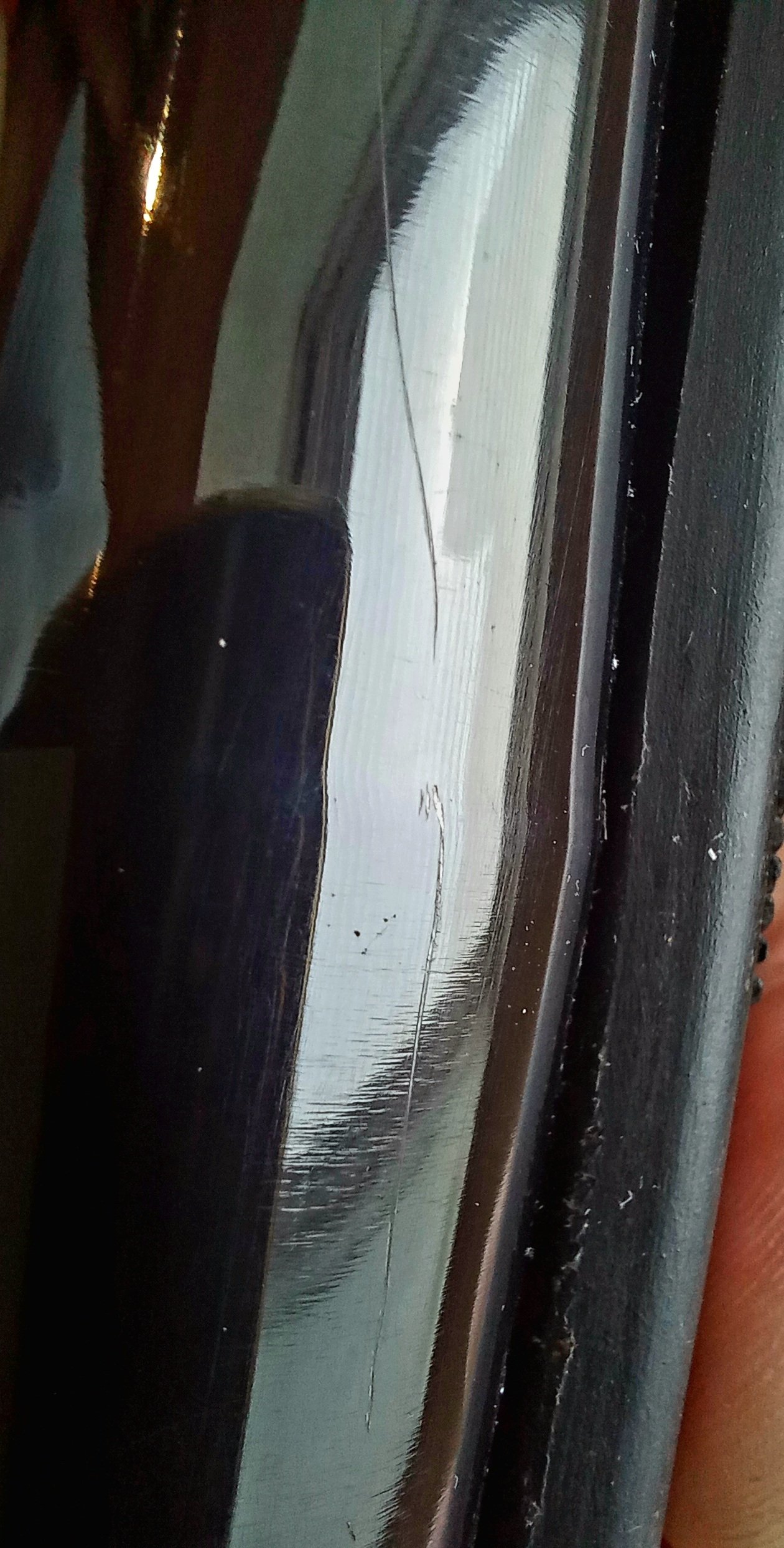

The gun appears to never have been fired and I had some concern when I thought to notice a very fine hairline crack near the breach (gasp!) that turned out to be a long shallow scratch probably caused by some rough handling in the gunstore warehouse. Otherwise, the barrel bore is perfect, so is the crown.
