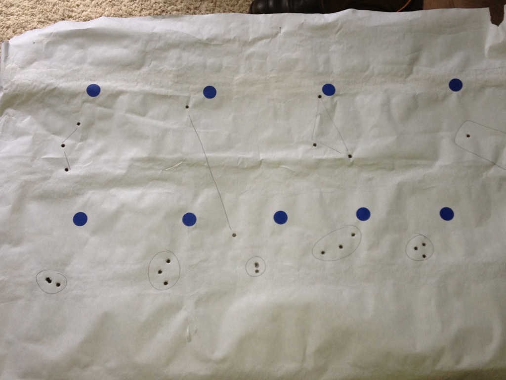

I took it to the range again today to shot the tests. I should post up a picture. What a joke from the VLDs
After the jump test it looked like I had a maybe in the range of 30 to 45 jump and at two loads but both 3shot groups were over an inch at 200. (the rest were more like 3 inches if you can call those groups)
Today I was also testing 80Amax's with 2000MR, never shot them with it so I had 5 loads with 3 shots each jumping 15 thou.
Barrel has about 100 rounds on it since the last cleaning
Just to make sure I got the best I could out of the VLDs I shot the lowest Amax load first. COld barrel 3 shots group is .31 MOA at 200.
Next I shot the VLDs
I had 5 loaded for each load with 10 thou difference in seating depth. One jumping 40 the other jumping 50.
First group I quit after 3 shots 1.3MOA group, waste of time
Second I quit after 2 shots, the shots hit 7 inches apart
Load 2 first group 2 MOA
Load 2 second group I quit after the second shot when it hit 3 inches from the first.
Went back to finish the OCW with the 80Amax
Second group 0,55 MOA (all vertical
third group 0.16MOA
fourth group 1 MOA, it spead out
5th group 0.225 MOA (came back together)
I'm pretty much done with 90VLDs. I've shot about 200 of them now in testing with 3 different powders and I've never gotten anything better than a 1MOA group for 3 shots, and every time I've taken that to test the next "group" looks like a shotgun pattern.
So you can see the difference graphically the Bergers were fired at the top row of dots and the Amax at the bottom.
I see you've said you're using a 7 twist barrel. Possibly the twist is a hair too slow? I've been told barrel manufacturers say 7 twist but truly may be be 7.4 or 7.3. You get my point and that could be very marginal for the 90's. I shoot a 6.5 pacnor 30" and will shoot 90's at 2880 all day long 3/4" groups at 200 yds.
Just guessing........
Looks like your barrel just does not like them... It happens. Looks like the 80 gr Amax is shooting just fine however, Nice mid range set up.

For whatever reason I've come to the same conclusion. I've still got to work on the Amax load and fiddle with it a bit but it's working OK. I shot it at 600 a couple of weeks ago and had some vertical that may have been me, I don't have much time behind this stock, but I also had a 5 shot string on the right side of the the 10 ring that the guy shooting next to me piped up and asked if they were actually moving my spotter or just running the target up and down.

XTR, you should go to Bergers website and play with the "twist rate stability calculator". A lot of your problems might be answered. I measured the 90's at 1.255 inches. Plug in all the data and see where you come out. Berger states on the website a 1.5 twist rate rating will insure proper stability. No matter what you plug in for a 7 twist barrel, the stability rating is "marginal" at best. AND, the colder it gets outside or the closer you get to sea level, the worse the twist rate stability factor gets.
I live at sea level and rarely shoot when temps are below 50 degrees and use a 6 1/2 twist barrel. When I enter in my data and use 2875 FPS, at 50 degrees temp and sea level elevation, my stability factor is 1.54. That is worst case scenario for me.
No matter what speed, temp, or elevation you enter, a 7 twist calculates out to very marginal at best. I think it's wrong of Berger to advertise a 7 will stabilize the 90's when on their website, their own twist rate calculator says a 7 will not reliability do it.
