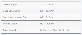

The 9.3x64 Brenneke is a nice improvement on the 9.3x62. The only distraction from excellence is the odd rim diameter here in the U.S. It's the middling caliber right between the .35 Whelen and the .375 H&H cartridges.
https://www.handloadermagazine.com/cartridge-board-7
