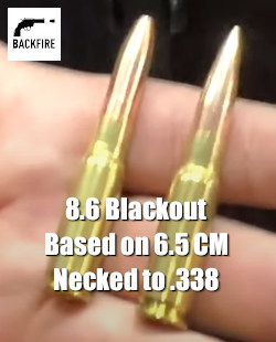

Yes, this is interesting. And actually, there are some new rifles being chambered for the 8.6 Blackout (see Faxon Firearms at 7:16 in video below). This is covered in this video at 4:58, 7:16 and 13:30. They are doing some radical twist rates (1:3") in short-barreled rifles. The goal, as the article explains, to provide stabilty at subsonic speeds, and also to work in very short barrels.
New 8.6 Blackout Cartridge with 1:3″-Twist Barrels
SHOT Show 2022
The new 8.6 Blackout “is a 6.5 Creedmoor shortened case, blown out for a .338 bullet [8.6mm = 0.339 caliber]. For supersonic… between 150 and 160 grains. Out of a 12″ barrel, we’ll be able to get somewhere close to 2400 FPS with that. We’ll have subsonic up to about 360 grains. A Barnes 210-grain bullet [is] about 2,000 feet per second out of a 12″ barrel.”– Q’s Kevin Brittingham It is claimed that there is more energy on target than with a .308 Win, even with a very short barrel
