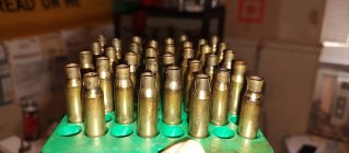

So been having fun with my first old...er , school wildcat. Don't think my 17-5.56 counts too much as a legit wild cat ..anyhow in making my brass with once fired ( got a bucket of stuff from the local range along wit a bag of LC saw head stamp and a bag of wolf) .223/5.56 found out the easy way to avotalot of head aches is to just test every case in the gun.
If they don't go in and let the gun close nice and easy there just not going to even after going in the 7 TCU die
Played with all kinds of shoulder bumps and stuff and really seems like the problem is the last 1/5th of the case.
Only thing I can figure is some of the guns have bigger chambers and the that part blows out a bit more and regular does don't really touch it.
So all that leads me to this. Would getting and using a small base die help alleviate this ? I've never used one but see people dealing with once fired 5.56 reccomended them alot... but never seen anyone messing with .7mm TCU mention using one.
I mean I just got 100 PCs of brand new starline brass just to convert and they all fit perfectly so I'm not stressing for brass but now I'm just curious on the matter.

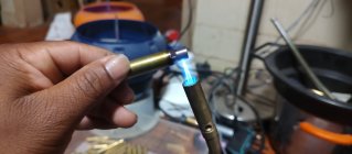

So here's the deal, I'm having zero problems when it comes to necking them up ,like none at all. I anneal till I get a flame change ( I played around. With flame change, templiq , and visual and they call are about the same from what I can tell, sometimes I'll use my fingers most of the time I use a drill with a socket)then just run them up in the die haven't had any crushed or split necks . Not quite sure what the point of a 6mm then 7mm mandrel would be unless I was no annealing.This things is a cake walk compared to necking down for my .17-5.56.
