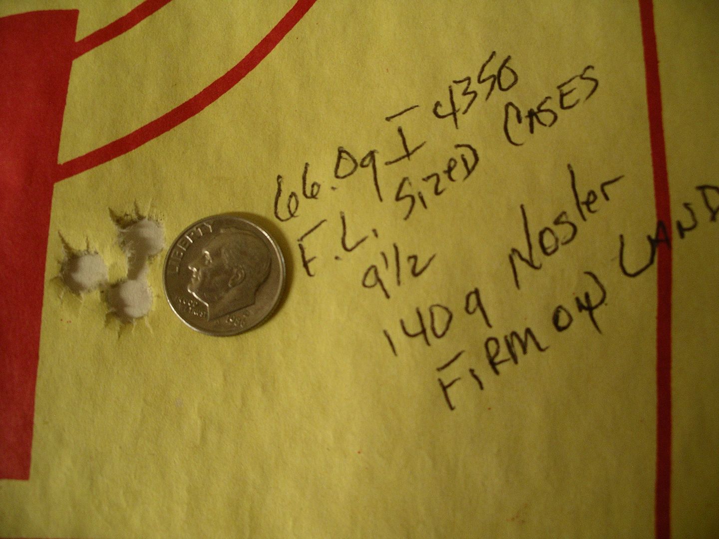

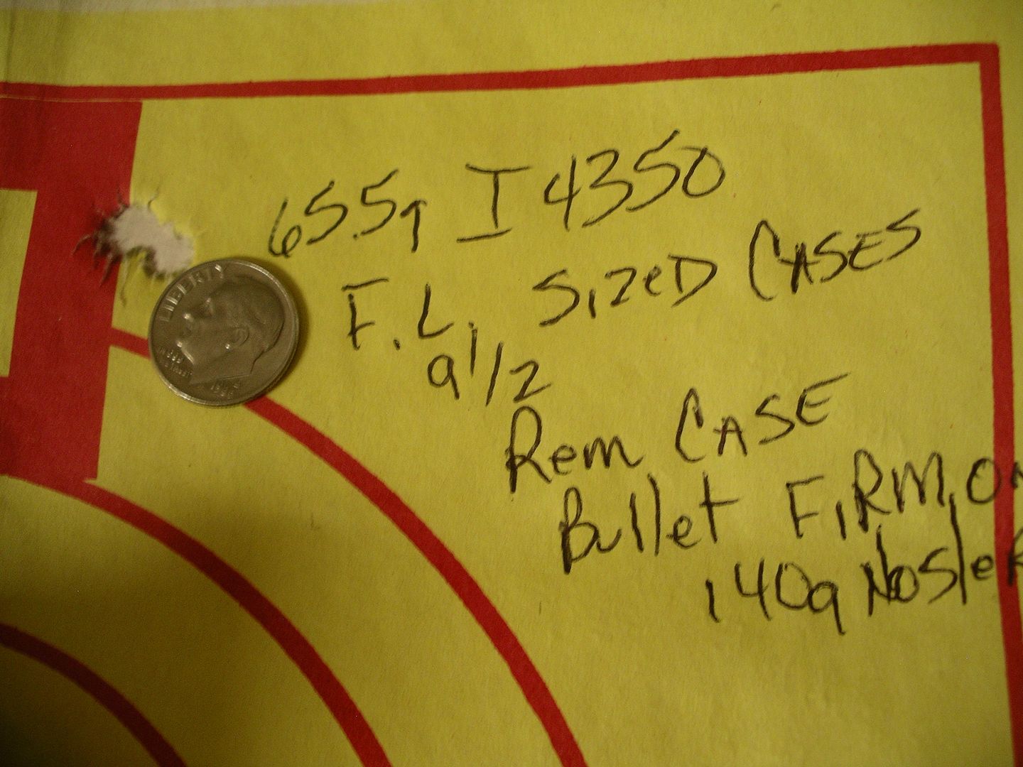

I have had several Browning A bolts
This load has shot very, very accurately, after I had a Williams or Gentry muzzle break put on them:
140g Nosler ballistic tip or accubond
Rem brass
Rem 9 1/2
65-66g of IMR 4350
Touch the lands with the bullet
Amazing accuracy.
Most guns like either 65.5 or 66g
I re spring my own A bolts
Best wishes and Happy New Year!

The load that I gave you shoots 3" groups at 600 yards with a High power scope,Bullets touch at 100 yards, and I have worked with 5 Browning A bolts in 7 mag, seat those 140's to touch the lands. Even two Browning auto's shot the same loads very well with the 140g. Several of the bolt guns shot 1 1/2" at 300 with the 140g and IMR 4350.
