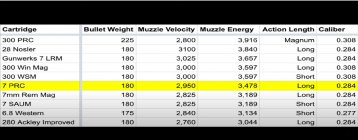

I don't know. The only two short magnums that have any relevance have pretty limited loads. I couldn't find any WSM or SAUM loads with 180s. The WSM showed 3000 for a 160 gr and the SAUM showed 2950. Perhaps that can be reached handloading, but I'm also sure one could handload this new round over factory velocity, too.
Based on the specs, I strongly suspect these velocities would be obtained out of a 24" barrel. Given this has a case capacity greater than a 7SAUM, I'd be surprised if it takes off in F-class given how quickly the barrel would burn out. With similar case capacity to the 300WSM, that usually results in barrel burn out around the 800 round mark when necked down to 7mm, hence why the 7SAUM has gained more of a following in the F-class world.

This was a screen grab comparing factory loads for the similar rounds. For some reason it didn't show WSM (from the lawsuit maybe?) but my ballistic app doesn't show any 180 gr WSM loads commercially available.
