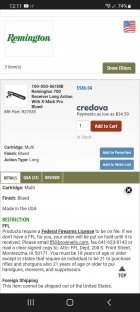

This kinda sucks! For the guy's that like to work with the 700.
At $4-500 it was still worth it for guy's to purchase one and either true them up or have them trued up. Then have a good action for a reasonable cost.
At this price, it really isn't worth it. When you can get a good custom action for a little more.Screenshot_20220206-121145_Chrome.jpg
