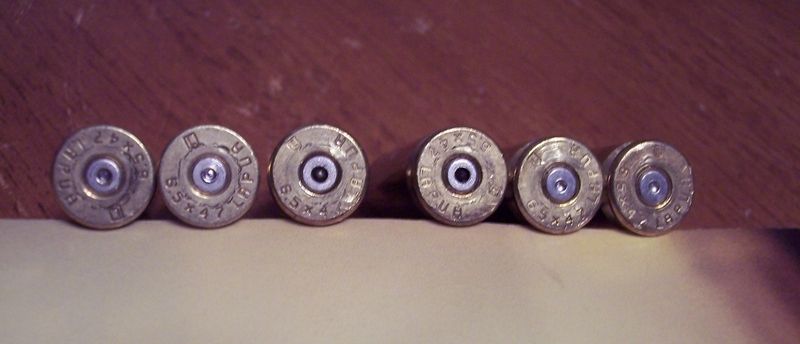

this is my only experience with this situation,,,I had a Bartlien bbl chambered for 6.5x47 and fitted to a Stiller Tac 30 action and shot the crap out of it,,,at 2500 rounds I had it set back and chambered with same reamer and fitted to a 700PSS action,,
the load is a healthy dose of H4350 and the 130 VLD
first 2 cases on left are from when the bbl was on Stiller action,,the middle 2 are from the 700 action with factory bolt and the right 2 cases are after the Gre-tan bush job,,,

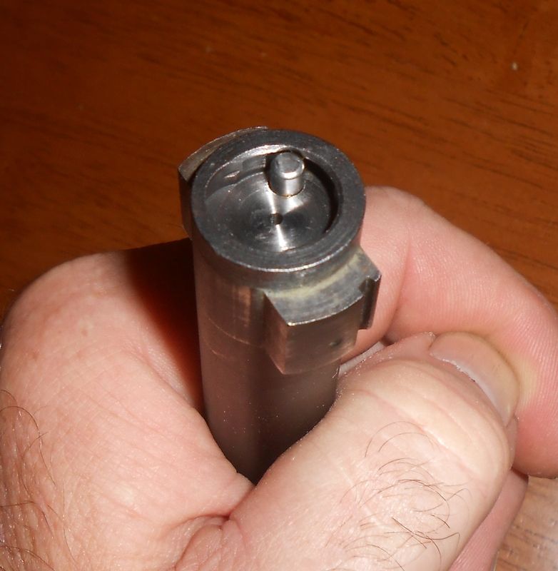

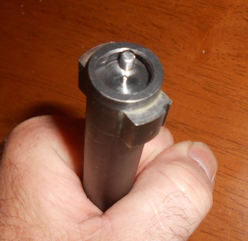

you can see from these pics how tight the pin is in the hole,
I cant think of any downside from doing this to your bolt
Thanks for the pics, they really do a nice job (Gre-tan).
It appears your bolt face has been turned, did Gre-tan do this when they bushed the bolt? Turning the bolt face would change your head space.
