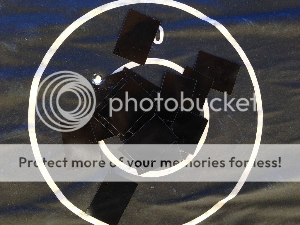

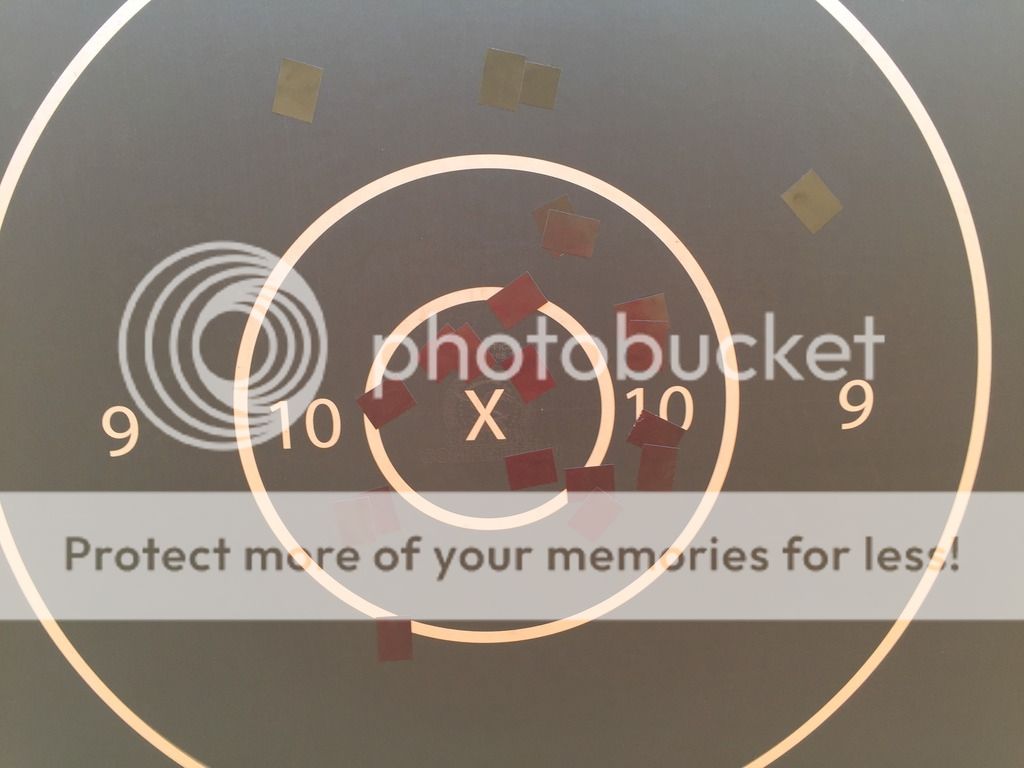

Ok well, look at some results from some matches. Load up some 90's in a 223. Talk to Gstaylorg,skiutah02, Laurie, myself along with numerous others on here and I bet this will change↓↓↓↓↓
I love the 90vld as much as these guys do, And agree that if you can shoot the 90'S i would most definitely do so.
Club Match 500 Yards 200-17X
1000 YARDS Practice
SWBN Shooting 90VLD

That's some fine shooting there, John! The 90s shoot well, no doubt, but cleans are hard to come by, no matter what you're shooting. Outstanding!
Thanks Greg, And thank you for the help last year at the San Diego match , your information help most tremendously and gave me the push to want to shoot the .223 over a .308.
