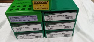

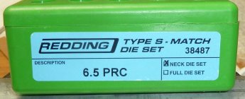

Doesn't the label on the die box tell you the shell holder?
