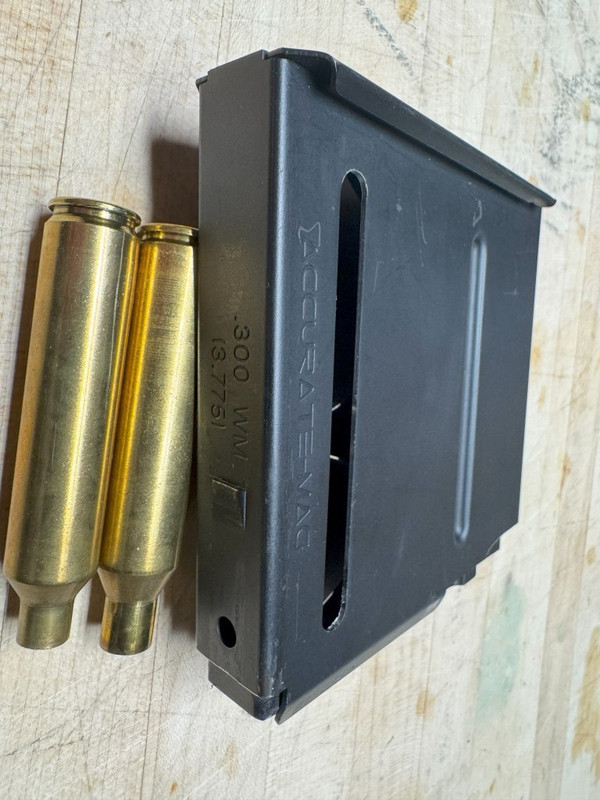

I've confused 2 projects. I did a 7/338LI that had problems with the front ribs on a standard 338 Lapua CIP mag. I twisted the larger taper of the lapua case to cover the base body diameter and give a larger shoulder. After measuring the 2 cases and pulling the gun out of the back of the safe, my error became clear.
I did the 26 Nosler project with a mid length 300WM mag and had to machine the one of the rear ribs to get it to feed.
The attraction of that mag was PTG makes cheap bottom metal that is a relatively simple fit into a long action R700BDL inlet. I had a bunch of them from earlier R700/300WM projects.
The Lapua case in back is a straight 300 Lapua. It was handy and close enough to the 338.
