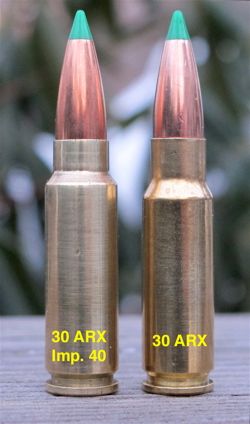

FWIW - - I am also working with a 40ËšImproved version of the 30 ARX (i.e. shoulder blown forward and 40Ëšshoulder vs the 30Ëšshoulder of the base 30 ARX case. I just don't have all the data compiled to do up a web page with chrono results, etc. for the 40ËšImp. version yet.

Here's a pic of the two for reference:
That 40 degree shoulder is awesome. What is the water capacity of it? Do you think it will perform at 30br velocities?
