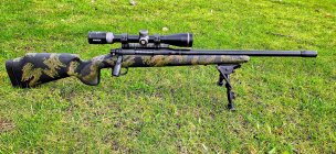

I had gotten a Mauser on the cheap.
Barrel & stock were toast.
Drilled & tapped (along with other assorted machining) the action.
Fitted a Dakota 3 position safety.
Timney trigger.
EGW one piece base, Vortex rings, Vortex Crossfire II 4-12X42 BDC scope.
Build was for my daughter.
Her & my wife ordered a Boyds AT-One stock (purple).
She's accounted for a few does with it using the 120gr Ballistic Tip.
