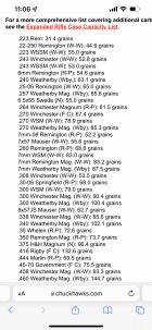

Everyone above is correct on the 480 case head which is something to be discussed. My initial convo with Phil was to find an easier case to operate from and deliver the 57-59 gr of water capacity that the 6mm Rem AI provides.
Currently, since Norma isn't really shipping the 7x57 or 257 Roberts cases anymore, that leaves hot rod 6mm shooters to either form 6 AI from 8x57 Lapua brass, or go a different direct entirely. The 6x284 is out of the game due to water capacity being in the upper 60s and you get powder choke due unless you rock a 32" or even longer barrel with the 75/87 gr bullet classes. Going down in capacity you get the 6mm Creed and the 243 AI, which to many of us 6AI shooters, are just kind of BLAH.
Enter the x55 Swede case. It sits at .4 grains larger than the 6mm Rem with both cases in their parent, un-AI'ed forms. When you blow out the shoulder it should remain very close to the 6 AI in powder capacity. This high 50's volume should provide the boiler room needed to see 3900 or damn close to it from a slow twist barrel and a 75 gr vmax.
the other concern I am trying to weigh out is CIP pressure concerns vs SAAMI. After scouring the net and talking with Jim Borden, there seems to be a difference of opinion vs where the pressure ratings are taken vs whether the metallurgy is just different for CIP built cases vs SAAMI. I am tending to side with the idea that the pressures are the same but the CIP is just monitored differently than SAAMI and thus has a smaller number. Similar to Miles vs Kilometers.
I have attached the case capacities and my first iteration of the reamer print....yes It's gonna be tweaked
