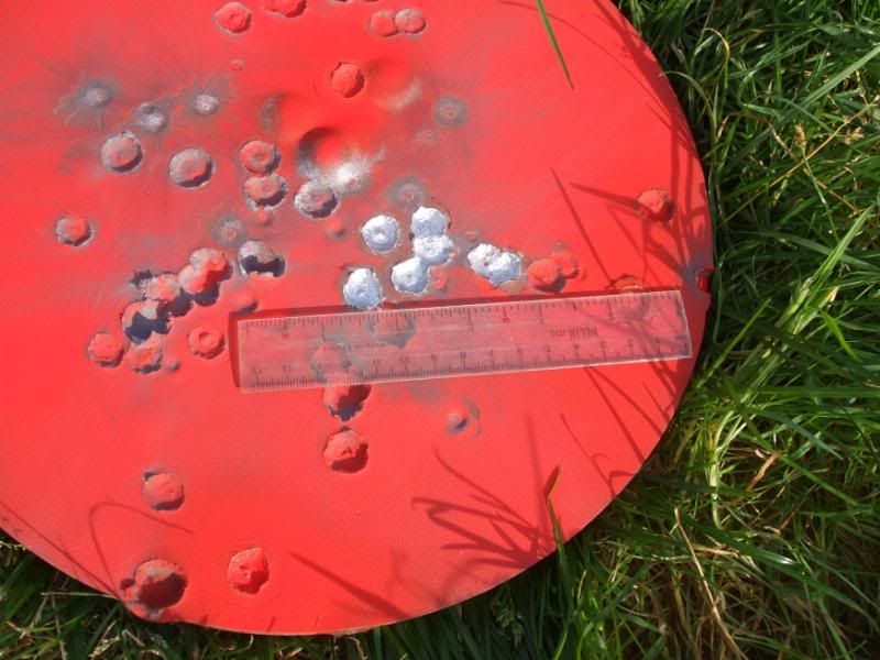

This 7 shot group I shot yesterday at 500 yards with my 6mmHot with 105 Berger VLD's.
It measures 2 inches center to center.
I think this will be my short range F class load for next season.
Load details are
39 grains of N160 CCI 450 mag primer 105 Berger VLD 10 thou into lands, gives a velocity of 2990fps. Safe in my rifle work up.
My barrel is a 28 inch Pacnor 4 groove 1 in 8 twist.
Cheers
Dave
