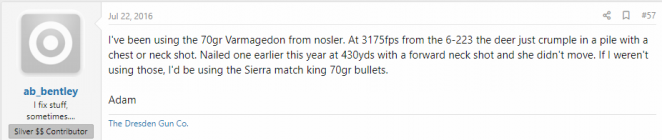

You might get close to your wanted FPS. I'm at 3000fps with 80grn Nosler BT bullets in my 23" 10-twist 6x45 bolt gun. I found the post below from Adam Bentley. I have great respect for Adam and his gun knowledge.
