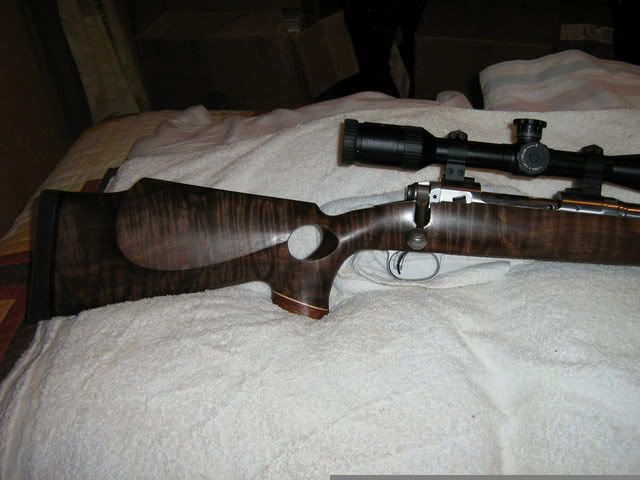

I have a Savage 12FVSS that I restocked. The caliber is 300 WSM. I am wanting to put a switch barrel, varmint cartridge for ground hog season. I was surfing the Pac Nor site and I noticed that they chambered a 6X300WSM. That might be a dandy. Can anyone give me any information about this cartridge? I would like to shoot an 85 grain pill in the rifle. Possibly a 100 grainer?? Any information would be helpful. I am considering this cartridge because it would be an easy barrel to switch back and forth?? No bolt work necessary. Tom.
