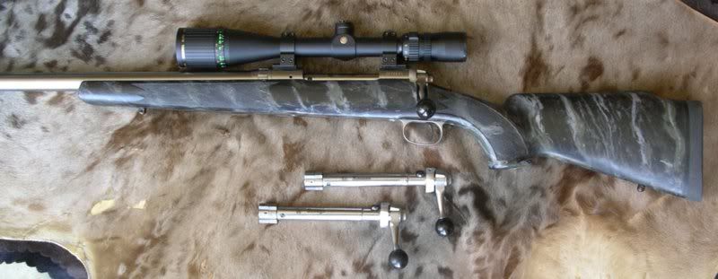

Have discussed with Pac-Nor and others about whether need to send my action to them to be custom fit versus them sending a prefit Savage barrel. They have all said the prefit would work just fine.
May not be properly qualified to judge custom high end hunting rifles, but think have seen some pretty nice rifles with prefit barrels. And have had good accuracy and reliability performance with many.
Pac-Nor has made Savage-type barrel nuts for my Remington and Weatherby rifles too. Having barrel nuts made for my Montana actions.
John Dustin has made similar rifles for me on Sako actions. His barrels are custom fit. Once one barrel is fit, Dustin can make additional barrels without sending him the action. Dustin's rifles can have the barrels switched in the field in a couple of minutes.
Haven't found any problems with the system yet.
Your experience with prefit barrels may vary.
