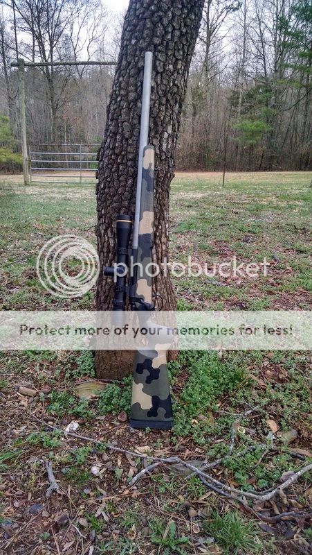

I've never had a problem killing our puny NC deer with the 6x45 no matter what bullet I used. I liked the chambering so much I built me a "good" one (Stiller, Krieger, McMillan, Jewel). For shots inside 100 yards you (or the intended target) will never see the 100fps "advantage" with the 204 or x47 case. FL size, load, shoot, drag & skin. Doesn't get any eaiser ;) .
Nice looking rifle, thats what my 6x204 is going to look like except a M7 action and a LT palma Kreiger. I just have to order the reamer so swd can twist it up. What barrel contour and length is it?

Thanks. It's a kreiger barrel in Rem Varmint contour. It's cut at 23" and gives just over 3100 fps with the Nosler 70gr BT in my current load with 10x. It wears a 4.5-14 LR Leopold with "flat" horizontal turret and a target vertical in Talley LWs that was to be milled out for the 8-40 screws.
