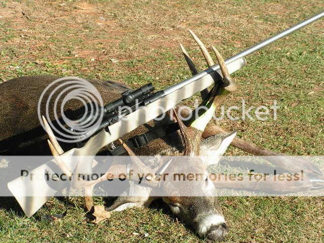

I've been shooting a 6mm-204 for about 8 years for coyote hunting and it s a great little cartridge. My deer rifle is a 25-204 and will push 100gr Partitions at 2800 fps. It works just great.
Took this guy in 2005 with t.
