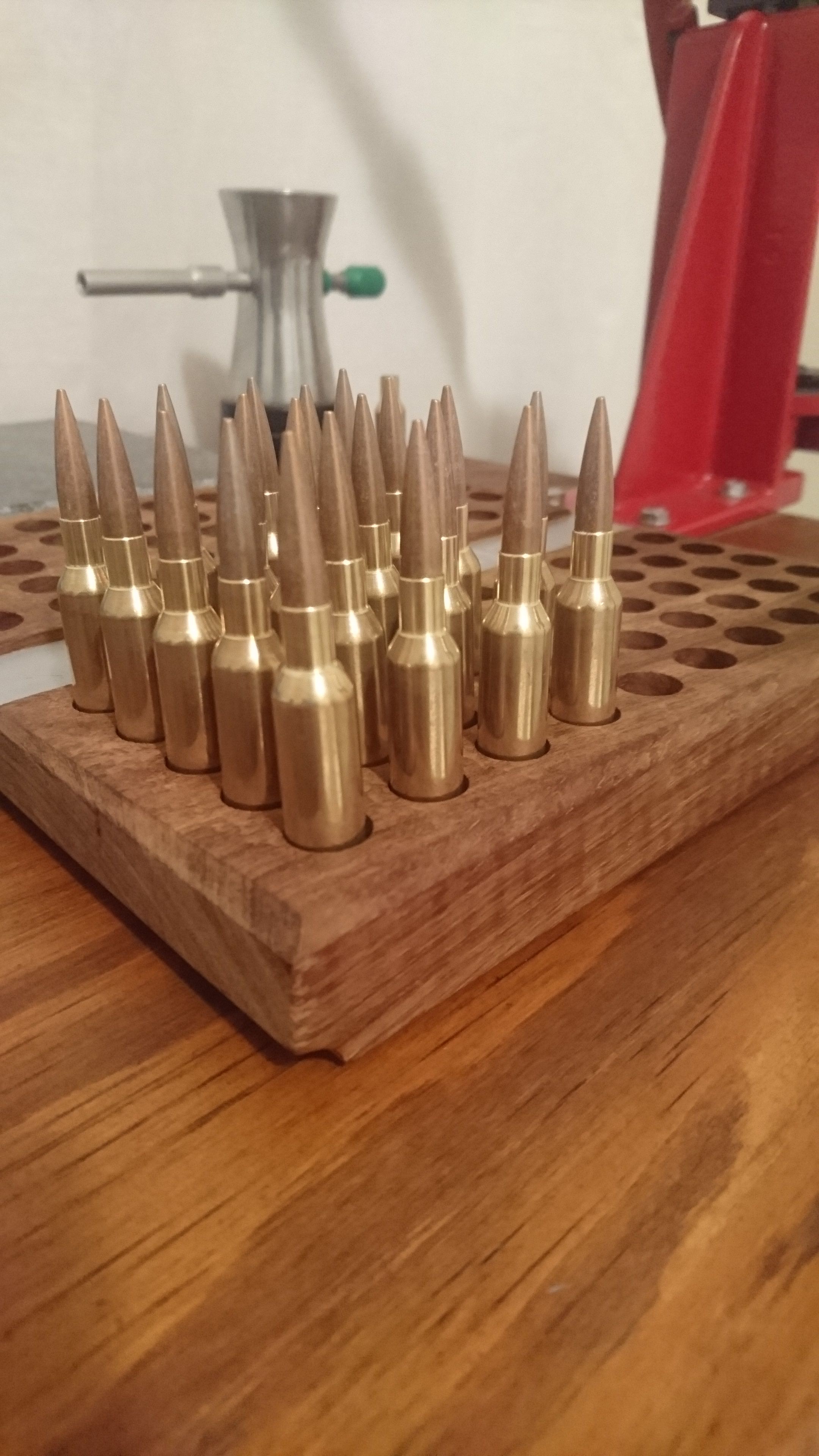

Sako brass gents, Sako brass
I have used and tried them all, Sakos where its at for ease of use and quality
If you want to go Lapua just speck your reamer for a tight neck as you will need to turn allot of brass but its doable, I went through 2 barrels with 100 pieces of Lapua brass and they are still good
Lapua Brass sized and neck turned before firing
