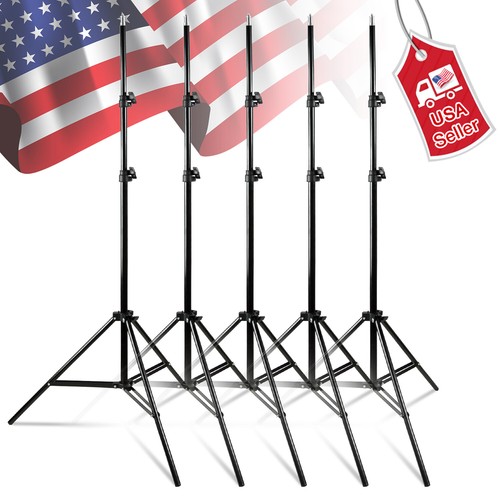

Here are some stands that will get you goin. Just need the adapters that he sells on his site aswell.
