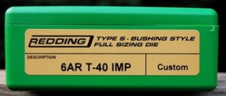

Hmmm - I guess a die set with a Redding Type S FL sizing die with a Competition Seater does not qualify in your book as "good dies". We have them in stock.

Whats Wrong with Redding Dies? I have been leaning toward Forester but have a fair number of Redding in the ole Sizing Die shelf.
