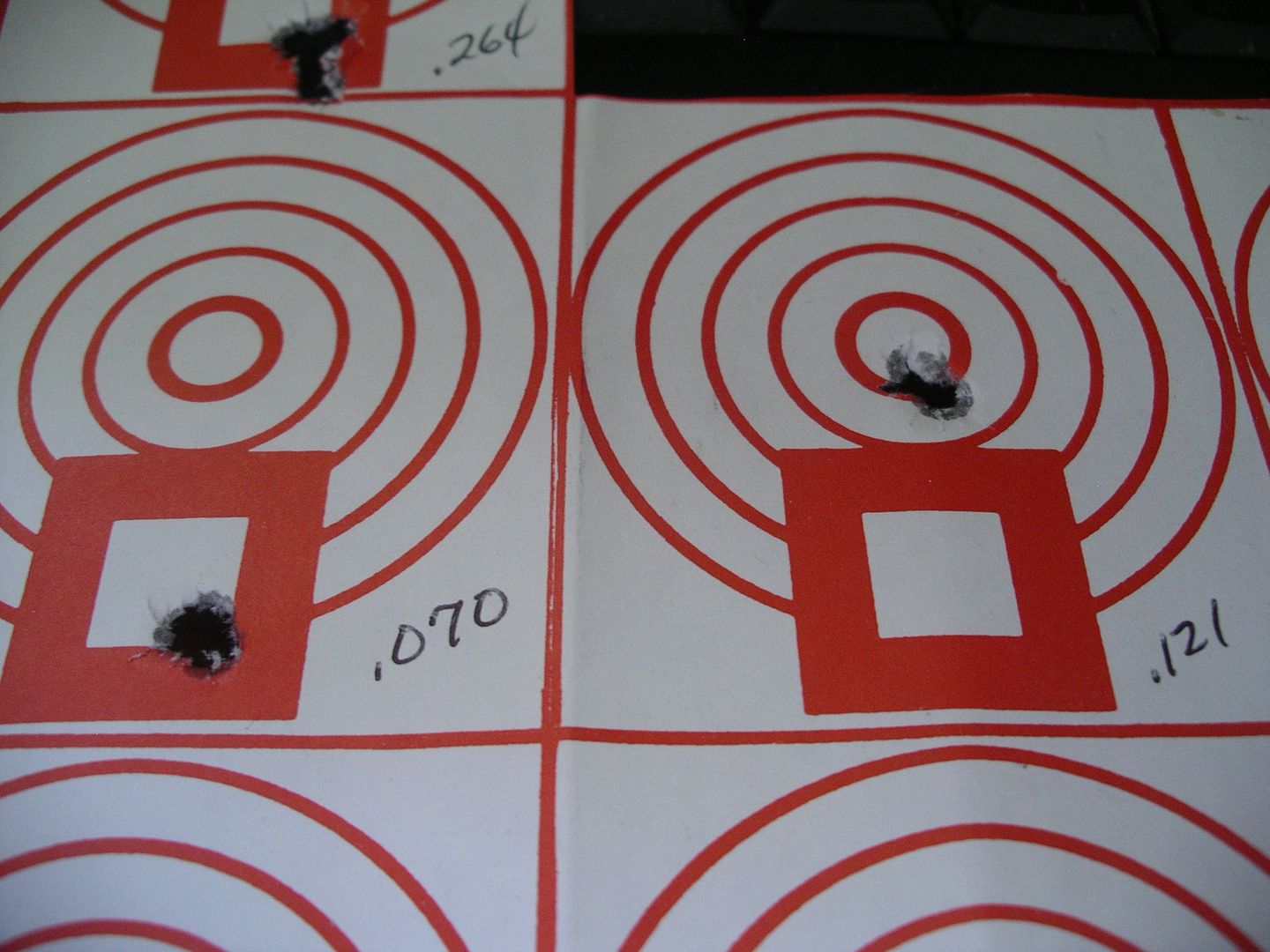

My use of SRP in the 6 XC, formed from Palma brass was stellar. With R#17, I had nodes at 3050,3150, and 3270 in a 31" barrel. The 3270 was the most accurate, and palma brass lasted for 5 firings. At 3150, brass life is still clucking along. I put 800-900 rounds on 30 pieces of Pama brass, still shooting 13 of them.
Accuracy was stellar with a RAS tuner with brake.
I used Paul Bike's form die set to form the brass from Palma to XC. I had a long neck to trim off. Instead of cutting the long neck off, I cut a neck .410 long in the chamber, then trimmed brass to a .400 long neck, then throated to ~.145
I saw very, very little leade growth in 900 rounds, and a very faint amount of fire cracking due to R #17?
Here are a few groups where I was adjusting the RAS tunner with brake, 107's with R#17, and 7 1/2's were much more accurate than 450's or Tula's:
[/URL]
The powder charge is 41.5g of R#17, in a .237, 31" barrel, 107's. 40.5g of #17 is 3150. 41.5g of R#17 blew the primer pockets on the first firing of std xc brass.
Reaching these top end nodes will demand small rifle primers in tough brass with brass having a shorter life than the next node down around 3150 or so.
