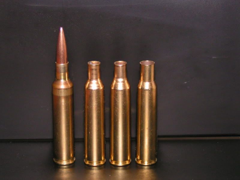

I have to agree with 40X, if you're thinking of using Norma or RWS brass then think about a larger neck diametre. My chamber is a .273 and I had to turn RWS brass down 11 thou to get a case neck of .271 loaded.
Winchester on the other hand measures .270 loaded with just a 75% neck clean up.
I would also agree with using the .257 Roberts die, I did manage it using a .243 FL die with the expander removed and then through a 6mm Rem FL die but it really works the brass.
I fire formed with cream of wheat and found it to be easy and cheap.
From right to left are RWS 7x57, after running it through a .243 FL die, then a 6mm Rem and the final case fire formed and loaded. And for those of you with good observation this is a 6mm Crusader and not the 6mm AI.
