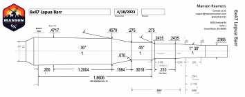

6x47 Lapua, .210 freebore, .275 neck.
Here is my print for the reamer I had purpose made for the 115 DTAC. So far it's working out way better than the .150 freebore on the old one.
