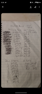

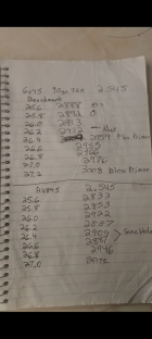

Disclaimer, do your own workup on load data as I'm not afraid to push limits but I also know the risks posed by my actions. So I'm showing you some of my data and velocity,but by no means am I saying to follow this. I will try to find my AR data this week and post it. But I'm gonna say 20-22" would be my choice on barrel length if I were to be using it for targets and game
