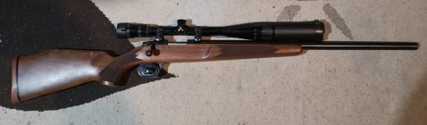

Well I purchased the rifle. Really like it. With the rifle the previous owner had these RCBS dies. He wasn't a reloader. Shot factory. I called RCBS and a tech toldIMG_0512.JPG me they were custom dies not for the PPC USA chamber but knew little else about them. Do any of you guys have any info on theses dies. TKS
