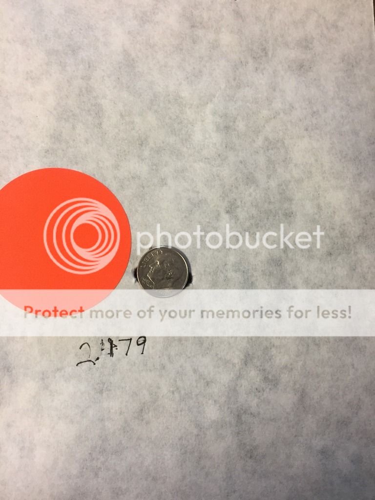

Had a quick session this morning playing with seating depths. This one certainly looks good. Won't have another testing session until next week prior to my first 600 yard match. This was shot at 500 yards 3-5 mph winds with 103 gr Dominators with the Grinch.

The best part is they are both AR15 's we shoot a bipod but the rules are no rear support other than your hand this gun will shoot right with my 6 BRX it's the craziest thing I've seen in a long time. I also shoot it in tactical matches. It won the NOR-NEV match in June 2016 I started with a Kreiger barrel 1in 8 twist 2inch extended gas system after 2000 rounds my groups started to open up so I set it back 2inches went with a standard rifle length gas system and I am getting close to 2000 rounds again I get about 12 firings out of my brass, Lapua I will post the typical groups I get when I do a zero check before a match 20170306_203804.jpg 20170306_203353.jpg
