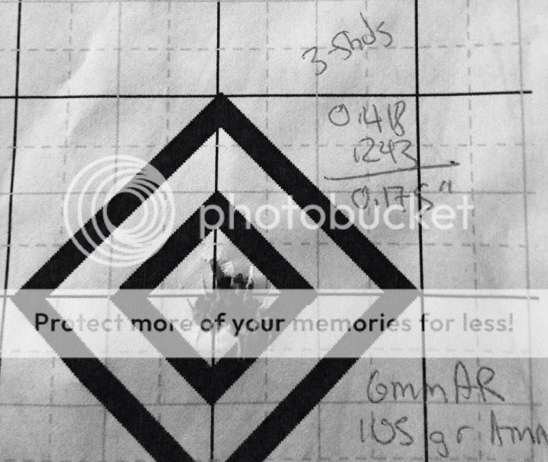

I've ran a 6mm AR Turbo 40 from Robert Whitley since 2011. It's taken a mountain of coyotes, including one at 750 yards, numerous antelope, and 5 mule deer.
I use 105 gr A Max's at magazine length going 2810 fps. That load is plenty accurate, but a little hard on the brass. I fire-form with 87 gr V Max's and they work just fine for plugging coyotes, other than having to crawl around in the snow trying to find every piece of brass after emptying a mag on a runner :)
Overall, I'm pretty happy with it. It was a little finicky on load work up, but shot well once I found the right combination (Varget & Rem 7 1/2 primers)... For some reason mine just didn't like the CCI BR-4 primers as much as the Rem 7 1/2's...
I had it built with a 25" krieger barrel and a lighter than standard contour (.750 to the gas block and 0.730 to the muzzle), which balances the rifle really well. Heavy billet upper & no side discharge handle.
I'll see if I can dig up some pictures in a bit...
