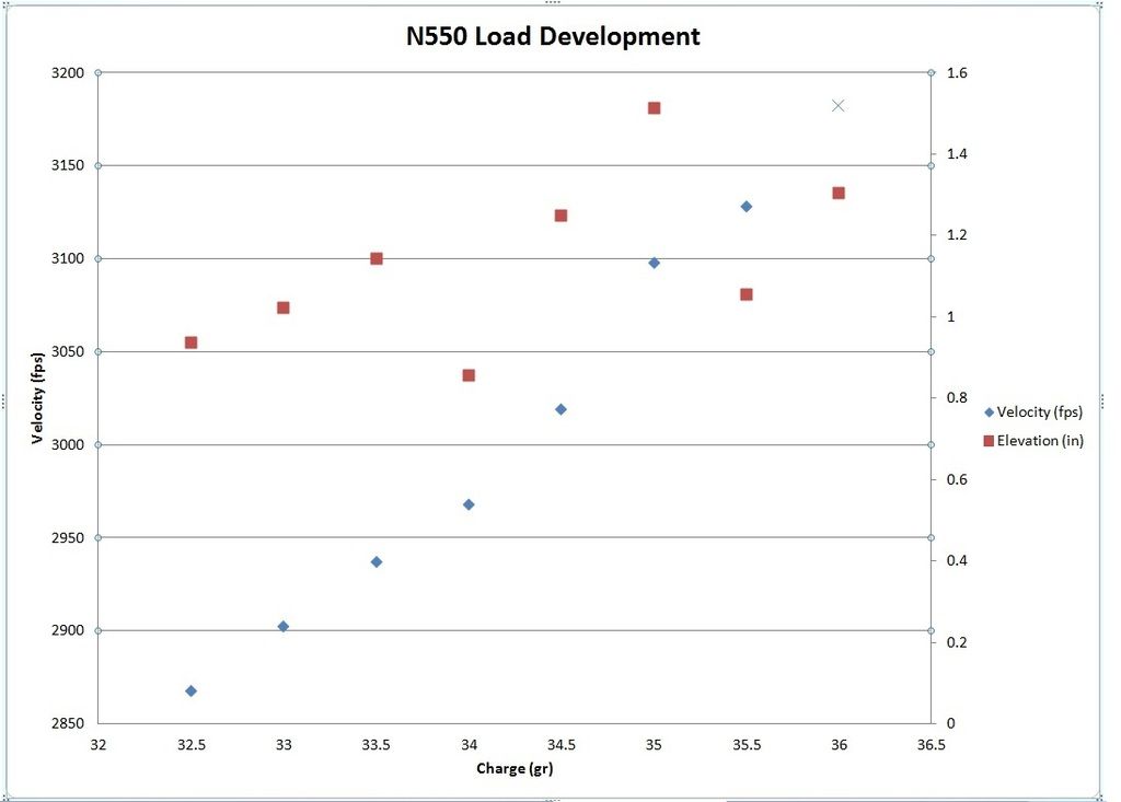

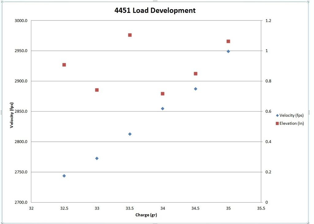

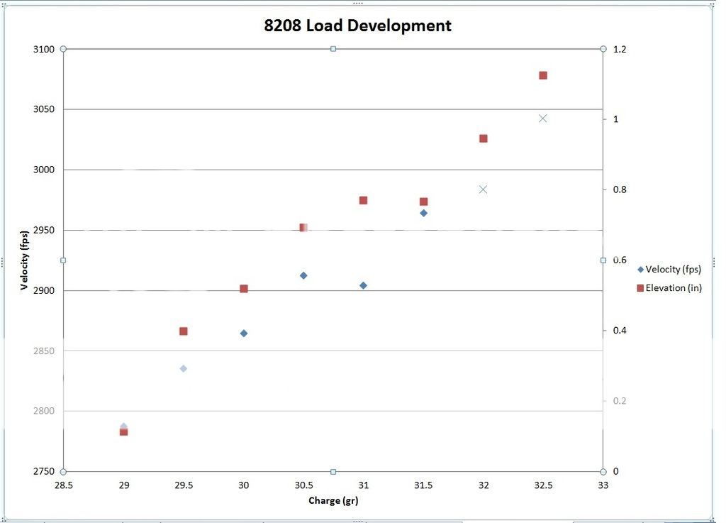

Shot my first look loads with some new powders for my new Dasher today. I tried IMR4451, Viht N550, and IMR8208XBR.
Gun:
Savage Target Action
McGowen MTU 28 inch
Bostrom Laminate Stock
Neck: .269
Bullet: AMax 105 gr
Primer: F205M
OAL: Base to Ogive 1.793 (0.005 off the lands)
Brass: Lapua (1st firing post COW fireforming)
Temp: ~65F
Pressure: ~23 inHg (7000ft)

I should clarify that the signs of pressure observed were very slight ejector marks on the case head. I didn't find the ejector marks on the 8208 31.5 and 32 loads until I got home under close inspection with a bright light. None of the loads had difficult bolt lifts or extractions. The gun craters primers (even with a PTG bolt head, much better but still present) so it is difficult to evaluate primer signs.
IMR4451:
Started compressing the powder at 35 grains. Not fully compressed but crunching powder upon seating the bullet. Not great velocity but didn't see any signs of pressure. Just too slow for this case volume.
N550:
Great Velocity! Started showing pressure signs at 35.5 gr. Moderate ejector marks at 36 gr. Don't really see a plateau in the elevation.
IMR8208XBR:
This powder grouped the best overall out of the three tested. There may be a good window around 31 gr. Started showing signs of pressure at 31.5 gr.
I want to continue with both the N550 and the 8208 but first want to check out RL15 as it seems to be the goto powder for the Dasher.

Looking for some IMR8208XBR Dasher loads, as I have plenty of it. My RL15 is getting low...
I have a friend who uses it. It is VERY accurate in his rifle with 105 gr Berger B/T's.. BUT He is in the 31.0gr range (somewhere between 31.2 and 31.8 I believe) and it has modest velocities. It is a shade on the fast side for 105 class bullets. It can and will produce EXCELLENT accuracy but the speeds are down where a regular 6mmBR resides..
