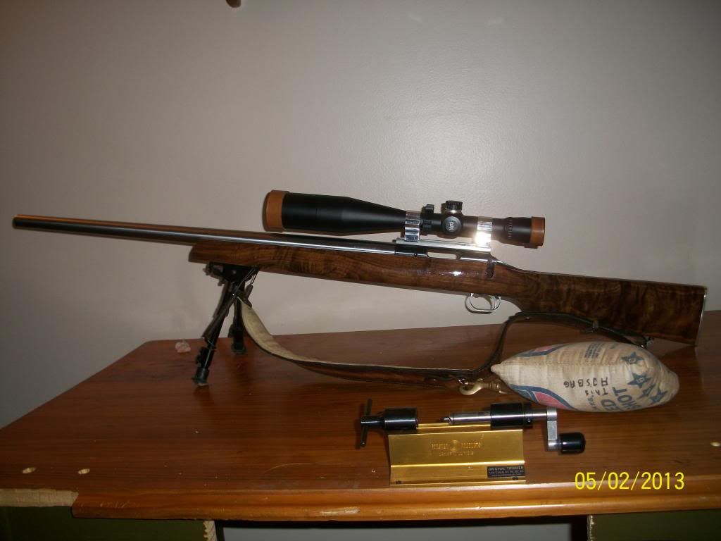

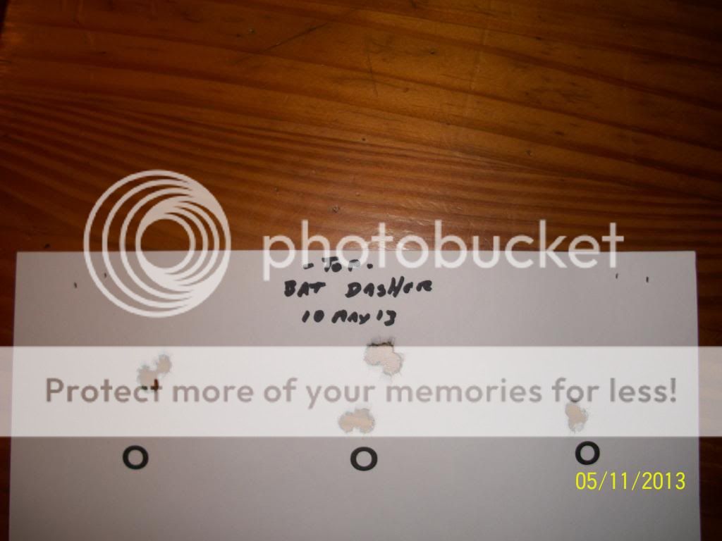

Here's my first groundhog load (yet to be proofed past 100yards) I've only done a handful of groups with this so far but its produced a .25 or better average out of several groups
1/12twist .060 FB
70gr. Nosler Ballistic Tips
37.5gr. Varget - a long drop tube needed and might be a bit hot in some rifles but I haven't noticed any in mine
-.020 off hard jam
3700 FPS
Here's some groups (I did a sight adjustment for the lower 2)
