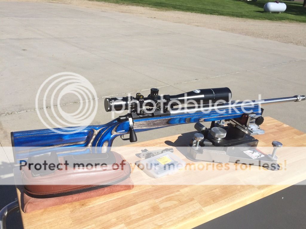

I agree with hoier, I just built one almost identical to what you describe and the Hammerhear from PR&T tracks beautifully, however if you don't care to change your rest top the Fiberglass St1000 is a very good option. Here is what mine looks like.

The 3" Lowboy from PR&T isn't bad either. I mean, it's no hammerhead, but it's still serviceable.
I forgot about the lowboy also, another good alternative. The PR&T's are very straight. Very nice Jason. Well Gabe, at least you have some food for thought.
I put an old barrel on it that I had setback so I could at least shoot it a little. Very little load work, it's been windy everyday and it's a new to me chamber, but it's showing a little promise. We'll see this weekend if it rains enough for me to play instead of work. It's going to take some getting used to, but I'm pretty sure I'm gonna like it. I have a new rear bag ordered, the stock is riding the hand rest part on this gater bag.
I planned on doing a hammerhead stock right up to the last minute. I got to thinking about the extra money I had to spend on a rest top/bag and then a new case to haul the thing around in. I just figured I would try the 3" and if I thought I needed 5" I could always add a plate to it down the road. I was worried about making weight too with the B action but I'm pretty sure it's light enough to add the plate and still come in under. It turned out better than I thought it would.
