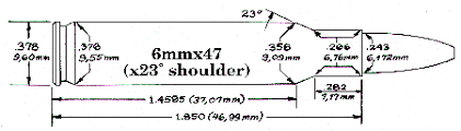

i am just gathering info, please let me know what the correct numbers are, just gathering info for fun
H2Onk lengthshlder ang
6x47 Rem31.128923

is very easy to get confused on the the specs for the 6 BR vs 6BRA. Simply put as I ascertain the reamer prints from JGS, the case wall on the 6 BR 30º is moved forward by .048 and the the neck shoulder junction is shortened by .004 and thus moving the shoulder angle back to 40º to form the 6 BRA 40º . The actual head space is .004shorter on the 6-BRA 40º than the 6-BR 30º.
all photos are off the internets, not mine
