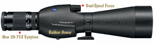

A couple weeks ago we did initial test of NEW Ziess 85mm Diascope with 20-75X eyepiece. We also had a Swaro 80mm (60X), Pentax PF-100 ED (~75X). Al scopes worked great viewing test targets at 235m.
But with the mirage that day, we couldn't see bullet holes much past 300.
On better days I've seen 6mm bullet holes @ 600 with both the Pentax and Swaro, and even a NF 12-42 riflescope. On one amazing day, with the Pentax, at 6:00 am just as sun came up, I could see 7mm bullet holes (in the white) at 1000 yards.
