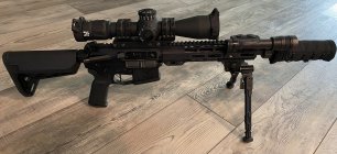

Both of mine are gas guns. I trued the face of the uppers, shimmed the barrel extension for a heat-fit, etc - but gas guns nonetheless. Here's the 10.5" setup for prone for 800yd steel:
Wow- well according to Hornday- they saw great results from all barrel lengths with the ARC. But.....that is really a short one!

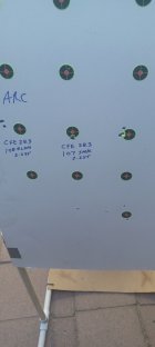

Found CFE223- 28.3, 107 SMK HPBT, 2.245 OAL, Hornday 6mm arc or resized Grendel to do very well @ 100 yrds (center group). The Hornday 108 ELDM (left group) same load specs - decent
I also loaded 105 match Horndays-group on very right (I didn't label it). The 28.3 is the starting point of 2500 fps which I believe my barrel likes.
