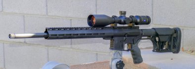

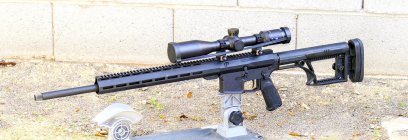

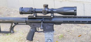

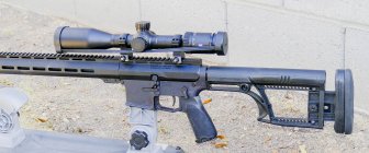

Some new pics.. Received the NightForce Extra-high (1-3/8") scope mounts and then removed the adjustable cheekpiece to get the scope up and my face down so that my eye is centered on the scope's exitpupil; that all works quite well now.. Scope is still the Zeiss Conquest V6 5-30X56X30.. Have changed the grip to some aftermarket one that feels better.. Am again breaking-in and developing loads after spending LOTS of time on my Big6 BR rifle.. Have sold all brass other than Lapua .220 Russian, which, of course, must be necked up (to 25-cal.), then resized overall, and then fireformed.. I use the latter loads for barrel break-in.
PS. I had installed the grip temporarily, without the safety spring and detent pin, for these pics.. That's why the safety is rotated randomly. ;)
